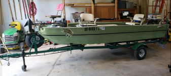

Dave_1972
Jul 15, 2021
10
And here is a picture of where I am at today. I hunted down replacement stickers (including the 1970's leaping bass and Ouachita Indian) and have applied them after working out some of the oxidation in the fiberglass.
Next up:
-Finish up polishing/waxing the outer hull.
-Start investigating the state of the 50hp Evinrude.
