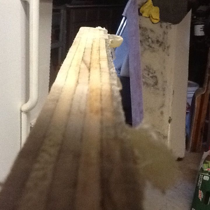

Does anybody know how far the polyester resin soaks into exterior plywood? I guess what I'm actually asking is, if I use 3/4" exterior grade plywood and cover it with polyester resin and of course the fiberglass clothes, has anybody actually cut through such and seen how far the resin soaks in? More curious then anything else. :decision:
jbcurt00
Oct 25, 2011
25,173
Not as far as you'd hope or expect........
There's more then 1 Topic that has this type of discussion in it. Usually comes up in Topics that start w/
Can I, or how much do I, thin poly/epoxy resin?
But to the best of my knowledge, nobody has done any destructive testing or micrometer measurements of absorption depth into plywood for poly or epoxy resins on iboats. I suspect the data may be out there on the net somewhere and Ondrvr could probably give you the info based on his professional experience. WOG too for that matter, so if he doesn't reply soon, hit WOG w/ a PM to reply to this Topic....
And, IMO, any posted 'tests' by iboater's won't be in strictly controlled environments w/ detailed parameters that would make the results repeatable nor that would yield results that would translate accurately to the real world where we're all working in widely varied environmental temperature/humidity conditions w/ various plywood from various sources.
Rickmerrill
Mar 13, 2014
686
I was thinking "not as far as you'd hope or expect" too. I just took a picture of the ski locker cut out and to my eye you can't tell but here us what it looks like. Also look at the glue joints, no "soaking in". But as long as long as it adheres...
Woodonglass
Dec 29, 2009
25,930
Here's the deal. The resin Can't penetrate the plywood on the Flats any further than the first layer of wood laminate due to the urea glue used. It's the Edges that are important and any voids on the flats. These areas are where the resin can and will penetrate the best and the most. It's also the area where water will try to penetrat too sooooo you should really pay attention to doing a good job there. But, applying a LOT of resin to the Flats of plywood for the purpose of saturating it is... Pointless. NOT gunna happen except for that first layer!!!;)
