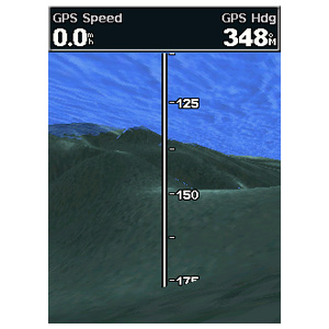

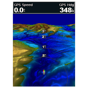

Re: How do you use a depth finder for safety..
Yeah, and the best chart plotters now have a variety views that show you underwater contour.
Of course GPS cannot assist with migrating sand bars etc. But identifying the deepest channels in a given area can really help. Combine this with your sounder to verify what the screen is showing you and you have some pretty good info for decision making.
