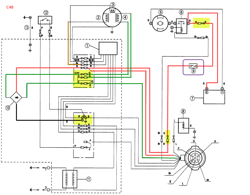

Gee, disconnect the stator wires from the rectifier and then disconnect the red wire from the rectifier. If the fuse still blows, that is not the issue (obviously). Now check the accessory wire (usually purple), and trace it to each gauge and anything else it connects to, looking for melted wires and rubbed off insulation.
boscoe99
Aug 22, 2013
2,095
There are numerous connection points within the circuit from the lighting coil to the rectifier and on to the battery. Or from the battery through the fuse and on the start switch. Presumption being that your motor is wired similar to its Yamaha equivalent. Start by disconnecting wires as mentioned above, hoping to find where the problem lies.

Isolated the rectifier. Ran jumper to console controls. Started and stop many times. Throttled up and down. Put I gear. No issues.
So new rectifier will be here friday.
neokane
Jun 19, 2023
7
Dectifier is putting out between 8.5 and 11v from red to ground at 5.5 to 6 amps.
Don't have new rectifier yet. But 20 amp fuse is till holding after removing rectifier from the equations
