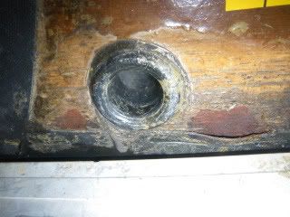

I have an Avon inflatable and when I was cleaning it out after a trip this weekend, I noticed some very minor spots of rot in the transom (dark brown spots next to the drain hole):
The wood feels a little spongy when pressed (depresses about 1-2mm), so I'd like to treat it to prevent it from getting any worse. Also, as you can see, it is also causing the hypalon to separate from the damaged area.
The transom is about 1 1/2" thick so it's not a structural issue yet -- obviously I'd like to prevent it from becoming one.
I called West Marine for advice on using their two-part epoxy and they recommended Git-Rot, which has received less-than-glowing reviews here.
Secondarily, the transom has a fair few nicks and surface scratches and I'd like recommendations on the right product to use to re-coat the entire thing at some point. I'm not necessarily thinking it has to be clear finish ... a black coating would look good too, as long as it's tough enough to withstand the normal wear and tear.
Thanks in advance!
Jon

Jon,
Actually Git Rot might be the thing to use in this case especially since it is a small area. Now might be the time to refurb the whole transom. I would strip the finish completely off. Sand it smooth. Treat areas with Git Rot. Fair all surface issues and sand again. Then followup with a good primer and paint. Might be worth removing the transom entirely and then doing the work. Then you could reinstall the transom with a haphylon or vinyl two part adhesive. It shouldn't be too bad.

Thanks. I've had the boat for nine months and it's taken that long to find an appropriate motor and get it running properly, so I'd rather not jump into a full-blown restoration just yet.
My main goal is to stop the rot from spreading until I have sufficient time to devote to a full refurb. If Git-Rot will accomplish that more effectively than West System Epoxy etc., I'll get some and apply it.

I think either will work. Git Rot is basically just a solvent rich epoxy. It is suppose to penetrate better. Remember that epoxies are not UV tolerant so you will still need to cover over the repair/epoxy with something.
