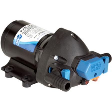

Installing a Boat Shower Pump
Things You'll Need
Shower pump
Wood or Rubber slab
Power Drill
Wrench
15-mm Pipes
25 Amp fuse
Screwdriver
Screws/Bolts
Nuts
Instructions
Identify a good spot on the boat. It should be kept as near as possible to the tanks storing water. It is always a good idea to position the pump at a point that is lower than the water tank base (bottom).
Position the pump on the wood or rubber piece and mark the holes. Do the same to the desired area on the boat.
Take the power drill and drill the holes on the slab as well as the boat.
Align the slab on the boat and place the pump horizontally on top of the slab.
Insert the screws or bolts and attach the nuts underneath. Tighten with a screwdriver or wrench.
Connect the pipe from the water tank to the inlet side of the filter. Another pipe should be connected from the filter's outlet to the inlet of the pump.
Connect another pipe from the pumps outlet to the shower. You may also place a filter between the pump and shower head.
Locate the pump's positive (red) wire and splice it to a positive power source in the fuse box. Place a 25 amp fuse while making sure power has been disconnected or switched off. Connect the other black (negative) wire to a negative point.
