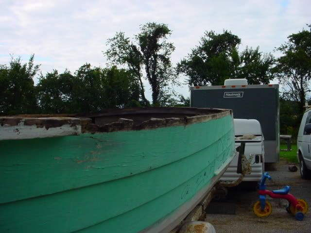

Ok..here is some stuff I got done today...Got the bad section of rub rail off:

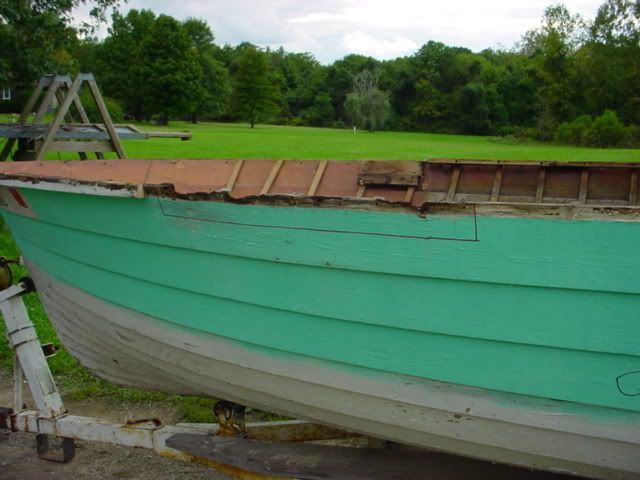

Here is the other section of plywood I need to replace

Got the two sections of rotted lap board removed yesterday....did it with a cut off wheel and a 4" grinder....cut it out and cauterized the wound all in one shot!!!
