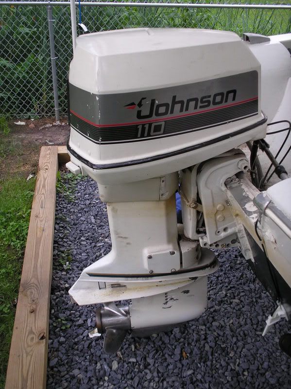

never take a sellers word. do the necessary test yourself, if they won't let you move on. compression, spark, lower unit oil. test drive. while testing disconnect the shift cable and shift to reverse and see if it will stay in gear. usually the cable goes bad and needs to be replaced.

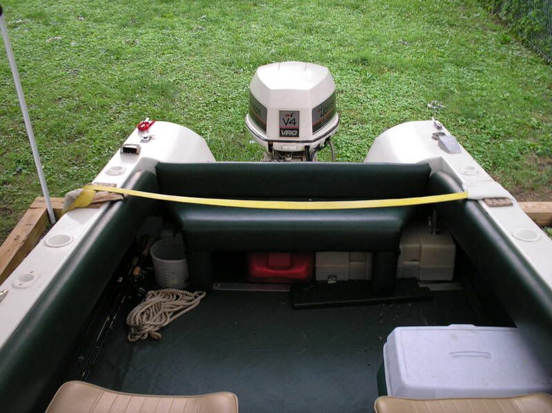

I just wanted to point out the one picture of the transom with the side shot of the motor. There looks to be a issue with transom going on, silicon or something applied sort of sloppy and globed on the transom and other areas. If you end up with this boat, I would check these areas to make sure there is no leaks, and that there is not any cracks or stress fractures in the fiberglass hidden underneath the silicon or through out the wrest of the boat. I know some of it is above the water line but it looks like its caulked all the way around the motor mount with a very sloppy job. Also if you go to look at this boat check the under side of the hull (the bottom part of the boat), for holes or scrub marks. Just my 2 cents. Also take it for a test run and see how it does, the man should agree to take you out on the water and let you get a feel of things.

Looks to me like there was allot of silicon used on the back of the boat. In general I would check for cracks through out the hull of the boat, especially around the transom area the back of the boat. Check the bottom of the boat for scrapes and any signs of holes. Sorry it took so long for the reply, I had a problem with the internet while trying to post. I am trying to find a cable to give you an idea on a price. The worst part is that something could be broke in the gear box of the lower unit. The cable could just use some adjusting. Being that old of a boat it may have some transom rot going on there. Transom being were the motor bolts to.

A very big job. You have to remove the motor, dig out all the old wood and replace it with new sealed wood or a product called SeaCast. However, that might not be a deal breaker. The deal breaker would be if the reverse issue is something with the lower unit and not the cable. $2k for that engine and trailer isn't a bad price even if the boat needs a little work. Just know what you're getting into. Lots of threads on here about transom replacement.

Take it to a marina and have them give it a once over. Understand that with that old of a boat there will always be some issues. If there simple ones you feel confident you can fix yourself, or can be fixed cheaply, then it looks like a nice boat. You just don't want to get in over your head. The transom is what the back of the boat where the motor hangs is called. I too wonder why this area on this boat is all gooberd up. Also a lot of these older boats can get water under the floor. Then it gets soaked up in the foam under there and can be difficult to remove. Take it across a truck scale. Unhook it from your tow vehicle and see what the boat and trailer weigh by themselves. Then compare that to what there suppose to weigh.

Sounds good to me but not to disappoint you but if you ask the inspector at the marina if the boat is worth it don't be surprised if he says no, and he may mainly say that about the hull of the boat. I would have him check the transom (again the back of the boat where the motor bolts to), see if he will go over it with you at the marina if you plan on taking it to the place. I'm not saying the boat isn't worth the money, the motor alone plus the trailer to boot would be worth the money, but if the transom is rotted you are not going to be able to take it and use the boat for long term without repairing the transom rot. It's better to go out there with a piece of mind that you have a new transom install and you don't half to worry about the motor going one way on the water and the boat going the other way, (the motor breaking off the boat in other words). I agree with Caveman Charlie and these other guys. And I reup (bring this back to your attention) about post number 5 of this thread about the gear box and shifting cable. I failed to find just the cable on BRP due to my internet problems.

Then as for the transom, this is what he told me:
"It's not leaking. I was using it when I installed the Fish Finder and and I had a whole tube left over, so I used it wherever it look like it needed it.
The boat is Solid, especially for its age."
