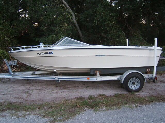

Well, for those who have been following my project boat and helping with a few problems along the way... we finished the engine work a few weeks ago and got some items installed.... went for the shake down cruise yesterday and she fired up and ran great!
(Boat is a 1972 Sea Ray with a Mercruiser 165)
Here's some before and after pictures:

Re: A few before and after pictures
Very nice job, love those old Chevy inline sixes!

very, very nice fm...... looks like yer all proper too. even got the reverse waterflow for yer manifold...... very clean..... nice job........

It looks Soooooo much nicer than the before picture. I personally hate RUST on an engine !!!!!!

Fishermark
Oct 19, 2003
5,617
Well thanks to all! ;)
How many hours? Quite a few hours actually, but as I said before, it's enjoyable right? Isn't that why we are all here really? We all enjoy getting a little grease under our fingernails.
My dad will have a fine, simple boat when it's all done. My brother works at a fiberglass shop and he was able to lay down a layer of glass over the entire interior. Here's another shot - they even built a new doghouse for the engine:
Among the items replaced:
-new gas tank
-different (used) transom assembly
-different (used) outdrive
-engine rebuilt with new...
...main and rod bearings, rings, oil pump, lifters, carb rebuilt, new manifold and riser, pertronix ignition and coil, rebuilt head.
-new trim pump and different (used) rams.
-New shift cable
-all new switches and wiring
-new bilge pump
-all new hoses and belt
-new seats
Shall I go on?
