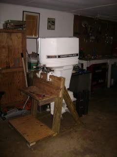

I built this outboard stand from some plans I got online. I can't remember where. (in here maybe) The design was done by D. Hayes Jr. I made it a bit larger than the plan called for and added a shelf. It is a good design if you are looking for one.
The pics make the base look as if it is bowed a bit. It is an illusion. The base is straight and supports the weight well. The whole thing is on casters and rolls easily.
BTW- $43.00 in materials, 3 hours build time cause im slow

One of the "tricks" to building a good OB stand is to get the angle right. I mean dupicating the angle of a transom, on a boat.
That way the engine will stand perfectly upright.
Most boat transoms are about 15 degrees.
Looks nice, GOOD JOB!

Re: A home build stand that works
