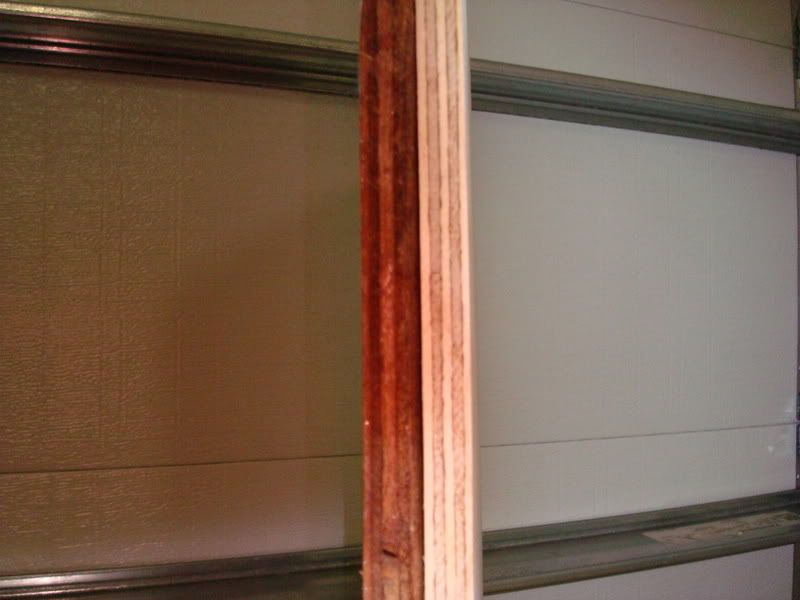

here is my progress, here is the new cut center lift out board compared to the old!
weider1717
Sep 2, 2008
315
The new is 5ply BC pine and the old is I have no clue CD pine or BC pine one? So anyway this was the only 5 ply in a 1/2" width within a 2hr drive that I called about and found..nobody else had 5ply 1/2" so I bought it, it was a good sheet of BC too the tiny knots you see on the bad side of the new board is about as bad as there was on it.
posting this because I know I asked a lot of questions and to be honest I am DANG proud of my finish product after cutting it out! I was amazed it turned out so good considering I have no experience at all with wood work. Cut the strip on our little 10" table saw and just put it on my dads band saw and took my time. It is a perfect fit!
only thing is the new one which is supposed to be 1/2" is very slighty under 1/2" and the old one is very slighty over 1/2"?? I guess the old one has swelled over the years not sure?

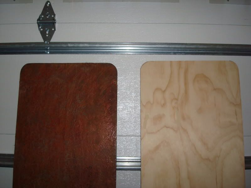

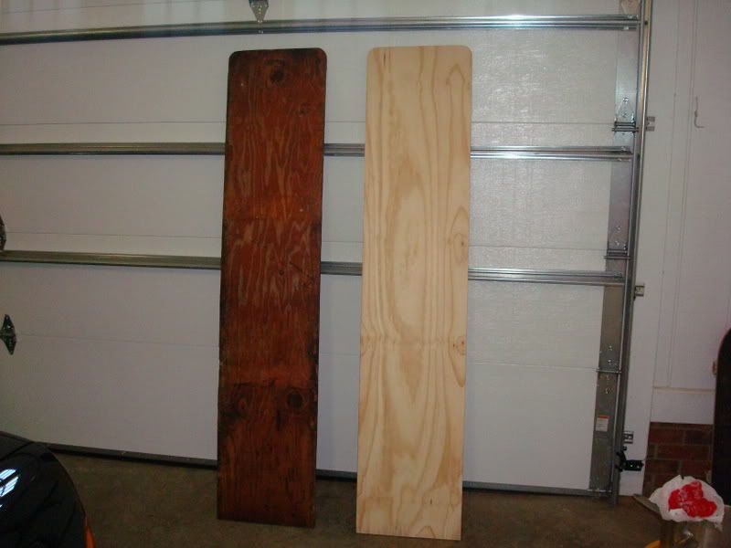

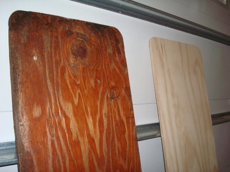

here are bad side of both and good side of both pics:
bad side of both
good side of both

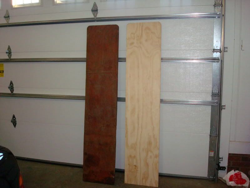

this image wouldn't fit on one post so here is the last one
