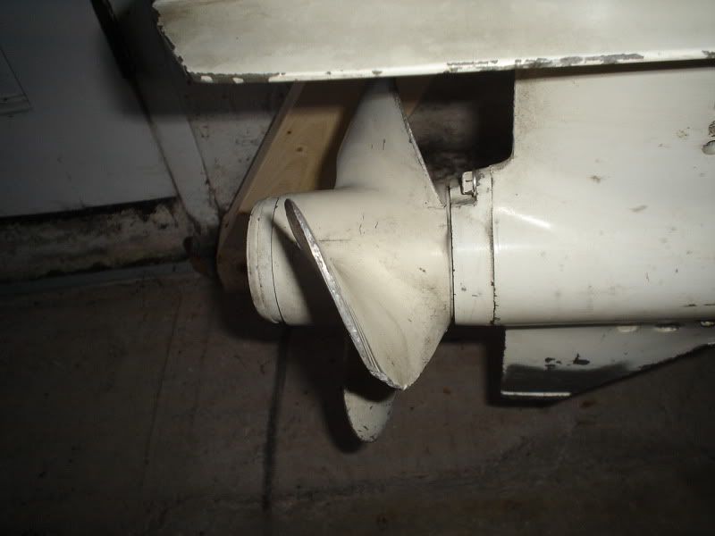

Hello, I just bought this outboard with a propeller that has seen better days. It looks pretty chewed up imo, though I'm new to boats (w/ motors).
Anyway, here is the pertinent information I have, and the information I am looking for:
1) Performance issue you are trying to correct. I feel like my boat could be going faster. it's probably going about 15mph, but I think the chewed up prop is causing the motor to be less efficient.
2) Current prop manufacturer, model, aluminum or stainless and as a minimum. it's aluminum; other than that I don't know. pictures are below
3) Current prop diameter and pitch (required). This is one of the questions I have. What is the pitch and what is a BETTER pitch for my boat (to make the boat go faster)?
4) Wide open throttle RPM and speed with an average load (very helpful) Sorry, I don't know this; the boat will be carrying no more than 600#
5) Engine/drive make, model, year, and HP 1983 Johnson 15hp
6) Boat make model, year, length and weight 1983 Sears gamefisher 14' fiberglass tri-hull, approx 250#
Also, I was looking for a good prop upgrade for under $100.
thanks for the help!

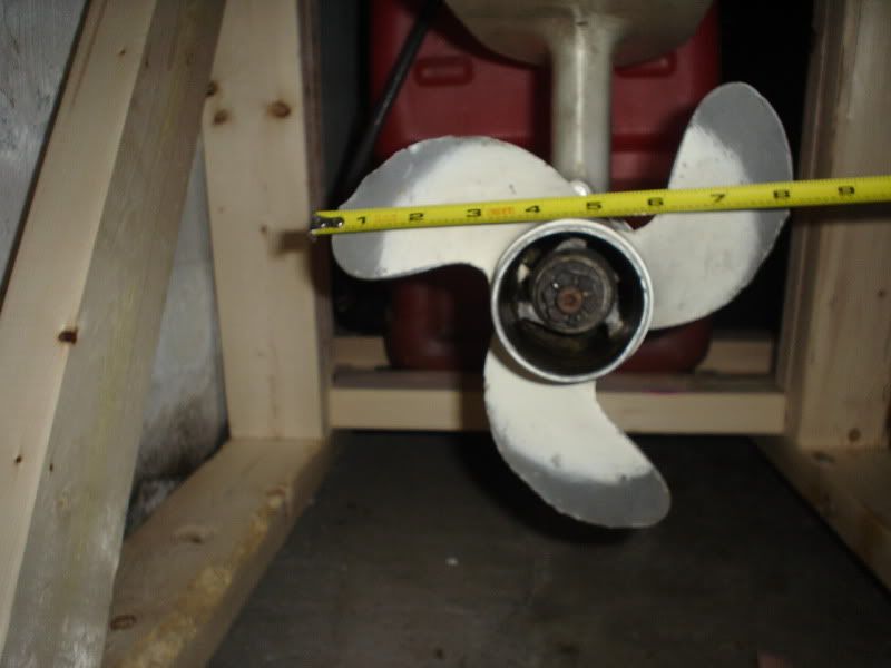

Sorry, I looked at the propeller more closely and got the following:
9 1/2 x 10
So the pitch is 10", I presume?

It would be a good idea to get a tinytach(reasonable and easy to install) so you could be sure of your rpm.
A gps for speed would be excellent as well.
Standard prop is a 9 1/2 X 10'.
I would stick with the same size.The motor is capable of 7,000 rpm but I wouldn't reccomend a higher pitch without a tach.
If the bow seems high trim in a notch,More later.

I wouldn't change props without a tach. Its not good to over rev any more than it is too lug a motor.My 5 year old Grandson could install tinytach with my close assistance.
If your hole shot is good your not likely to need less pitch.Move things forward if the bow seems high.Trim in a notch.
How much do you weigh? Be sure the throttle is opening all the way.
is the bottom clean.Your dinged up prop is surely eating up your speed.
Motor under ideal conditions could do about 25(light reasonably fast boat)
I would call your boat average. stock prop should work.A new prop will surely improve your speed.
If the boat is running bow high Sounds like a trim or weight distribuition
problem.A tiller extension may help so you can sit in the middle seat.
Also if the motor is very low on the transom.Antivent(cavitation plate) even with the bottom is considered a starting point.Most endup slightly higher.You can raise by adding 1/4" sticks on top of the transom.Just be sure clamp has a good bite and it pumps water.Raise the motor to a point just before venting(cavitation) becomes a problem.
