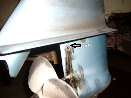

I have a mid 80's 25hp Evinrude electric start motor. No Power tilt/trim.
The other day I bought one of those hose adapters to put on the motor and run it out of water. Well, after not finding the water intake I decide to spray every hole with the hose. :eek:
Now, I have two spots on the motor leaking fluid.

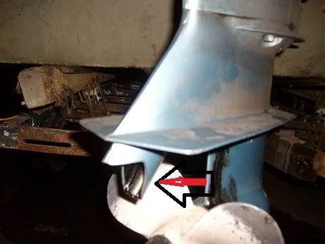

I have attached pics. Both spots are leaking slowly but surely. What have I done? is it ruined? :confused:
The first pic is where it is leaking out of a very small hole close to the "check fluid level screw". The second is some bigger hole that is square and has a round tube coming out also....
Any help is appreciated!

You loosened up 2 stroke oil in the exhaust housing in the lower unit and now it's running out. Enjoy the motor, it's fine.

Thanks a lot! I thought I had just trashed a perfectly good motor. Got it from an estate. Been sitting up for 10 years. Under the "hood" it looks brand new. And it cranked on the first try with new battery!

The red arrow in your first pic is pointing to the exhaust outlet/water pickup, make sure the lower is deep enough, 50 gallon barrel works, small trash can, not so much. There are guys who say flushette's work, some say only run in barrels, I have a 50 gal barrel for motors like this.

Man, you are a life saver. I thought it was junked. One last question... There is another outlet right under where the cover meets the shaft. It is two holes and exhaust comes out there too. Is that also where the water spits out too? Is it supposed to have exhaust coming out of it?

red water pickup. yellow exhaust, green exhaust relief at idle, mist should come out of it at idle.
motor has to be run in a barrel water up to just below exhaust relief. you cannot use muffs.

TD showed you a good diagram of where water goes in and comes out. If you look inside the spout in the lower where the exhaust comes out you will see a screen, that's the water pickup, I was just simplifying it for you. Glad we could help.
