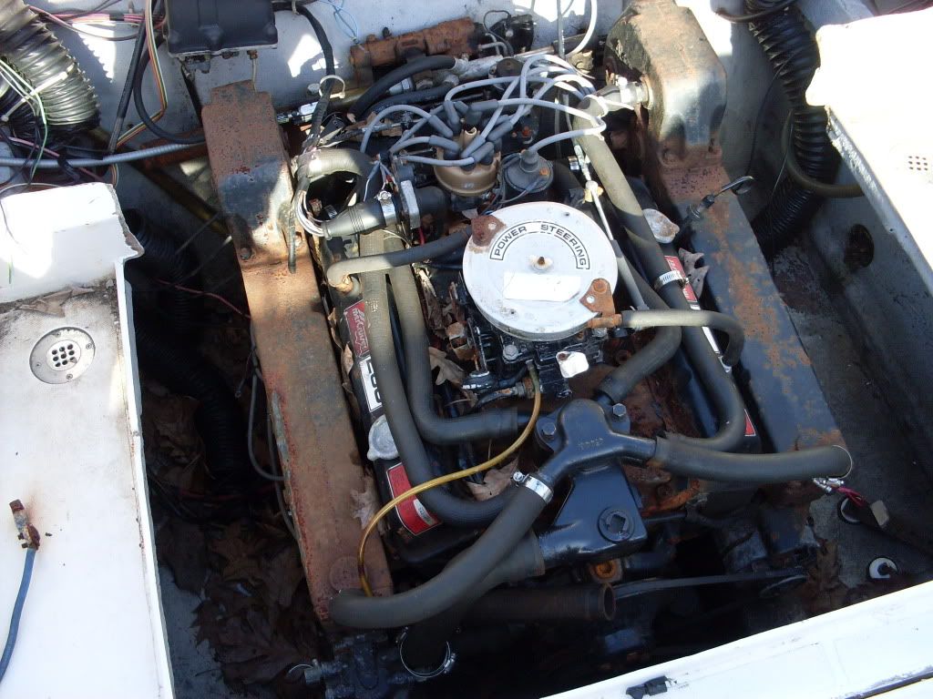

I purchased a exact year unknown (late 70's) "Classic Boats 250 Falchion" (can't find any info on the company) off of ebay for $355 dollars and found that the motor was locked up. This is a "wish you could retire" present for my dad that i want to have ready for spring.. I don't have much cash to put into it but am only looking to get a couple of years out of it till I can afford a full repower. I'm not really familiar with boats but can do just about anything to a car.

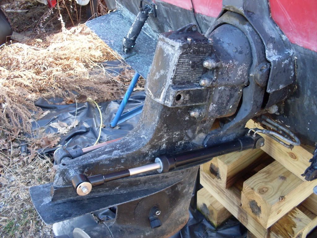

what I know so far it that it's a 260 hp 4 barrel mercruiser (locked up with rainwater in the pan) and a pre-alpha drive in unknown condition with a stuck shift cable and bent skeg. What are my best options to get on the water cheap and quick? I've found a reman long block w/ 2yr guarantee for $1300, but what are my options for the outdrive? I've read conflicting info on interchangeability, will a alpha 1 lower bolt on? is there a serial number on there somewhere to know for sure what I have? Is this a power up and down version? Is it worth putting money into?

. I don't have much cash to put into it but am only looking to get a couple of years out of it till I can afford a full repower. ....Is it worth putting money into?
There's a lot to evaluate and decide before you start putting money into this thing.
The engine - you can get the long block and bolt the externals on... but are the externals (starter, alternator, carb, manifolds, etc) any good? You need to evaluate them and see. New manifolds and risers can get pricey quick.
The outdrive - you can get it pressure tested.... but worse case scenario you can buy a brand new aftermarket drive for around $1,300.
How's the transom itself? Any soft or hollow sounding spots?
Steering system? Stuck?
LOTS of things to look at before you go any further.

The engine - The starter clicks so im assuming that it works, no idea on the alternator, but I'm not worried about getting them rebuilt. carb im sure could use a cleaning or rebuild (about 600 hours on the clock but don't know how long it's been sitting), manifolds are solid enough for a season or 2.
The transom is solid as a rock.
Steering system moves

so how about some ideas on my current plan... I'm thinking (after pulling a screw) get the long block for $1295 shipped (2 year warr reman) and have parts swapped over and put in by a shop, at the same time give the outdrive a going through (seals, impeller...) since it only has 650 hours showing on the clock. Wish I had a hoist big enough to swap the engine! Also considering doing the outdrive myself, depends on the labor time..
Thoughts anyone?

Hours mean nothing my friend. Get yourself a pen and paper and calculator and get ready for some real costs.
1. The bellow is probably or has been full of water. The welch plug on the shift slide cavity is missing. Pull the drive, look at the boots and gimbal bearing, If the boots and bearing are bad, then pull them and look at the transom shield, they rot out if salt water has been sitting in the bellows for a long time. If your transom shield is gone. Plan on spending 1-2K on a used shield new boots, shift cable, gimbal bearing.
2. Pressure test the outdrive. If it fails, pull the top cap and look at the driveshaft bearing and race, they are the first to rust up. If the bearing and gears are rusty, it's cheaper at this point to buy an aftermarket replacement drive. They run about 1400 bucks
3. put a battery in the boat and see if the trim system works. If it doesn't, you can plan on spending hundreds to easily over 1k if you have a bad pump, lines, or rams.
4. pull the risers off the manifolds and look at the discharge outlet on the risers and the water ports on both the risers and the manifolds. It doesn't matter what they look like on the outside, it matters how they look on the inside. Unless the risers are fairly new, it's pretty much a rule of thumb that a new engine gets new manifolds and risers. If the manifolds/risers fail in the future, they take the engine out with them. That's another 600-1k bucks on those.
5. When you get into a boat like this, the engine is the least of your worries and cost. 350s are all a dime a dozen, but all the marine parts, both in the engine compartment and whats hanging off the back of the boat, will drain you dry. Marine parts don't nickle and dime you to death, they hundred and thousand you.
Absolutely true.
Again, absolutely true. :eek:
With all the above being true, I do believe you can get a used transom assembly for far less than 1-2k. When I bought my fist I/O I had all the issues that Jason mentions and then some. Found out the hard way about rebuilding the transom, having a corroded transom assembly that needed to be replaced, etc. You can usually find a good used assembly on the various auction sites and Craigslist for a couple hundred dollars if you are patient.

I turned the outdrive to it's extents and the bellows look almost new, no dry cracks or anything. I'll do a more thorough inspection the the drive is off. The wires for the switches on the gimble are wasted though.
I have found parts cheap but am unsure what exactly will fit. From the SEI website I'm pretty sure a alpha one should bolt right up, is that true? When I put a battery in it the pump did not make a peep, but haven't checked for power to the pump yet.
I found a complete pre alpha set up for $500 (COMPLETE TRANSOM ASSEMBLY WITH TRIM PUMP,TRIM RAMS,INNER BRACKET AND EXHAUST PIPE), but it has a different ratio. Is it worth it/possible to swap gears? It's off a 1978 CV16 GLASTRON
http://cgi.ebay.com/ebaymotors/ws/eBayISAPI.dll?ViewItem&item=280483415950&ssPageName=STRK:MEWAX:IT
I've read that you need to put the drive in forward before removing, is that true? If so, since my cable to the shift bracket is frozen, is that a push or pull on the cable?
