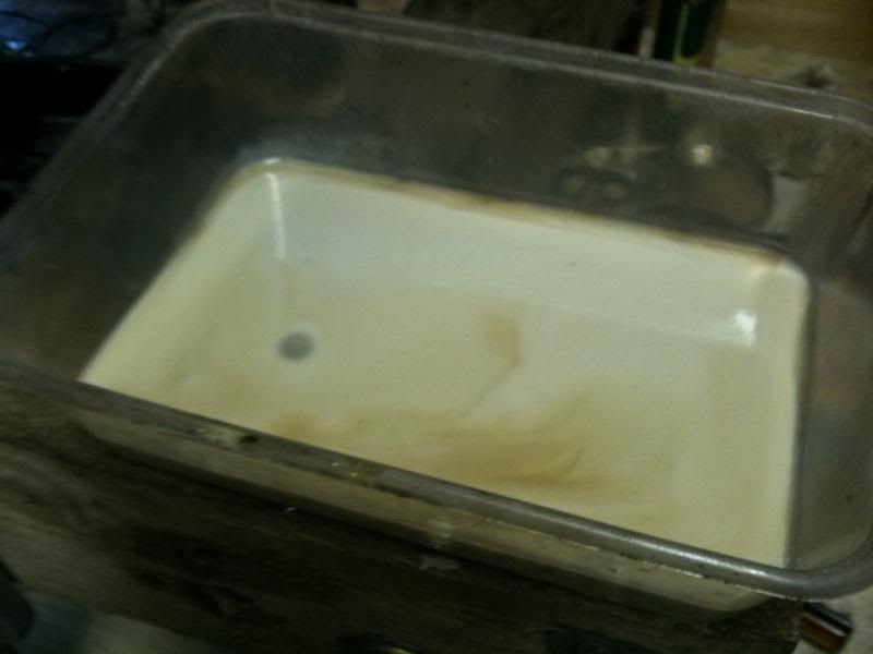

I dropped the oil from my 1980 evinrude 60hp 2cyl
The result is a tub of white oil. I changed the oil ran in a barrel, same result see the pictures.

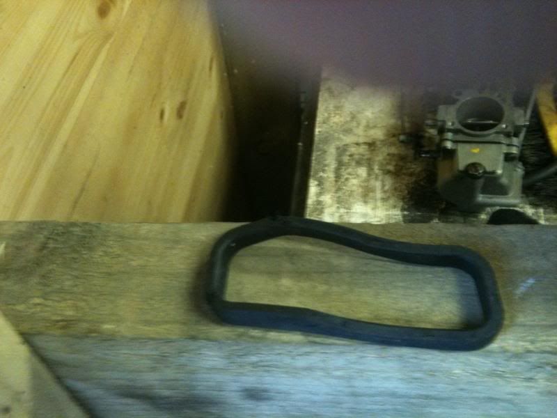

So i removed the propella and the rubber was squashed up in one side.
see pic below

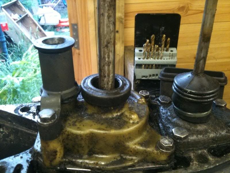

I removed the lower unit for inspection.
the drive shaft seal was full of old mastic / sealant
that fell off.
The gearbox is not losing any oil and the gears work as they should.
Should I be concerned?
Should I replace the drive shaft seal or is it as it should be?
Should I replace water pump seals?

It is definatley time for a reseal on the gear case and since you already havit off then you should invest in a new water pump as well. Water in the gearcase is a concern. Invest in a good factory manual and you should be able to do it your self.
