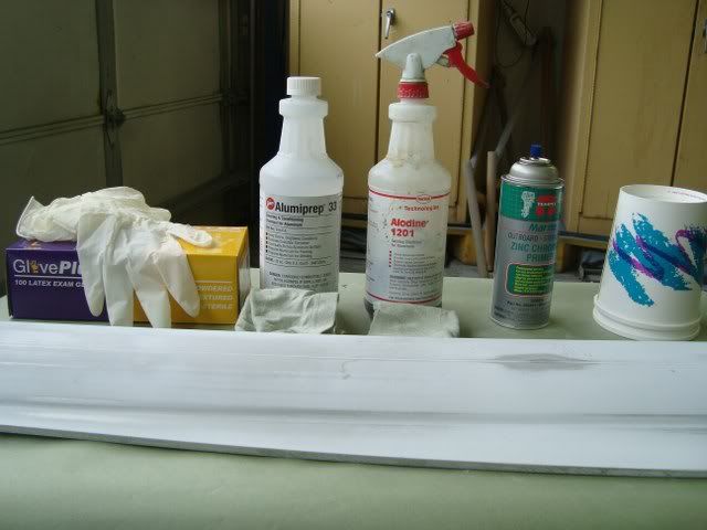

Just to share how I prep alum for paint..
This is the materials I use ( you can use and equivelant..)
With the mix of 1 part to 3 parts alumiprep wipe down the Alum ..keeping it wet with the Alumiprep.
Rinse well with water after about 3-5 mins of application of the Alumiprep.
Apply the Alodine ( you dont have to dry before the application of alodine ).
Keep the Alodine wet for 3-5 mins..then rinse well !! Notice the Goldish hue on the prepped alum..Thats what you want..
Let Dry..dont touch the surface ANYmore now with your bare hands !.After that is application of ZC primer..
After a few coats of the ZC primer has dried 24 hours you scuff/sand for your topcoat..
Never touch anything in these processes with your bare hands..
Good luck Alumipreppers : ) .

Thank You for posting that YD. It may seem simple to you, but those few pics will speak a thousand words to those that see them. I for one made the assumption your process HAD to be done on fully stripped pieces. I never thought you could "spot" prep.
One other question, one a brand new piece of 1/16" 6061, would you also roughen it up, or leave nice and smooth?
Dave.
Yacht Dr.
Feb 26, 2005
5,581
Re: Steps to Prep Aluminuim with pics
Dave..
I allways prep mechanically before these steps..
YD.

Alumiprep is phosphoric acid and either. The acid removes corrosion and the either dries the solution. I use vinegar which is not as strong and diet coke (not sugared coke) has a similar effect for removing the corrosion.
Alodine creates a slight chromate conversion which is why it leaves a green/gold hue behind on the bare aluminum...... essentially it is a chromate treatment. Following YD's prep method actually puts two coats of zinc chromate on the aluminum.
So...... in the past many of us (me included) have sanded, wiped the hull with vinegar, used a light coat of zinc chromate from a rattle can and then painted.
There have been reports from other iboats people that have received similar instructions from paint manufacturer's. It's your choice which to follow. Yes alumiprep and alodine are not common and can be hard to find depending on where you are.
I know you are painting a duck boat and it probably has seen some use and will continue to...... the paint will last using either method ;)
Regardless of which method you use...... be sure to sand smooth, feather any good paint edges left on the hull and most of all be patient! The results are all from the prep.
Sorry YD to infringe on your post. YD has the 100% correct method and my method is a "shade tree" way :)
Probably best to get your alodine and alumiprep on-line from a distributor that sells both so you only get hit with a single HAZMAT. I am not sure if they are ORM-D

But anywho.. yes there are other tried and true methods that Do work..I just like the fact that I can Alumiprep then Alodine ( pre ZC coat ) all at one time without worry about moisture vapor condensing on the part. I dont really know about the affects of vinagar to Alodine ( and I allways use alodine ). Ill get some scrap and do it both ways just to see for myself..
