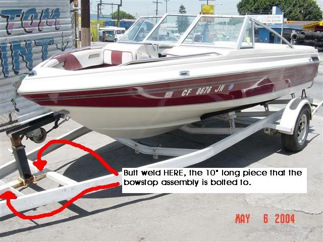

I would like to improve the versatility of my boat, and add an electric trolling motor for fishing covers and stream inlets for local (Arizona) lakes.<br /><br />I shopped around and the transom mount motors are MUCH cheaper than bow mounts.<br /><br />I don't have a fishing "chair" in the front and probably won't be able to control the motor via foot control.<br /><br />So.. due to the cost and control issue, a typical bow motor won't fit my needs.<br /><br />I can't find any bow mounts that are hand controlled, only transom mounts. I wonder if anyone knows of a way to make a transom mount work at the front of the boat (mounting and handle direction).<br /><br />Typical ski/fish boat from the late 80's...<br /><br />

Ignore the welding info, I already fixed that rusty thing in the picture :)
