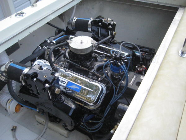

77 Century Arabian 200
7
454 after total blue print rebuild. Block magnafluxed. Align bored with torque plate. 5 angle valve on heads. Crank nitrated .030 over, Sealed Power h
79arabian
