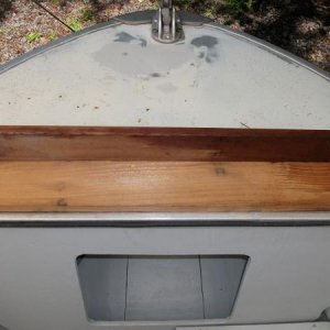

To get the fore deck to drop at a right angle so the trim work will mate up, I figure add at least three inches. The floor block could probably be fu

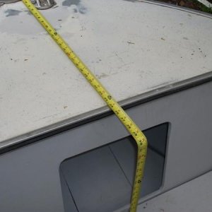

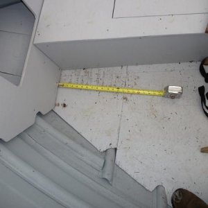

Since all these SCs should be the same, this is the length from last deck seam to anchor wall.

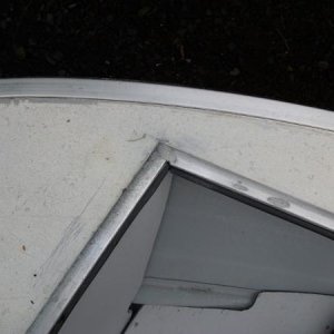

Starboard side trim fit. Notice holes in the salvaged metal. Someone had mounted pole holders and canopy hardware on them.

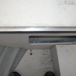

X-ray vision again here. This is how it's attached to deck and other is for interior shelf support. Note, had to have enough bow deck to attach 2x2.

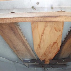

Use your x-ray vision here. I added a piece of 1x4 cedar, leaving the metal half inch longer to account for plywood wall. As will see later, should

Port side trim fit.

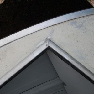

Because of that slant, the interior trim angles won't line up. The sides to match the existing trim had to be at 90 degrees so to solve that problem

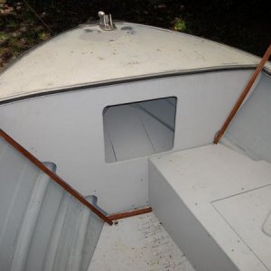

Someone said, experience is knowledge gained too late. Well here it is.. By not leaving the fore deck a little longer, the anchor storage panel slan

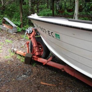

This is the 1970 Starcraft Jupiter I recently purchased. While it's a fine closed bow boat, I propose to turn it into an open boat.
