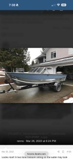

Ah dang it.... yeah the paint was actually really nice except for a couple spots. I stripped a small spot then just kept going... what a pain. 🤦‍♂️
I had seen someones boat with the polished aluminum and some side paint I think it was @renns ?
That made me want to strip the paint and polish. Anyone have experience with Shark Hide? Wondering how it holds up and if trying to polish the aluminum is going to be tons of work.
Ill leave some of the side paint and just paint over the top of it but too late now for the bottom.
