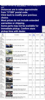

Find a used engine, car-part.com is a great source. Pull existing and replace and drive. Fix old motor with no time constraints. Save motor for the future or sell to recoup money.

Actual link doesn't work, but a search will.
Prices down there are much less than up here in the rust belt.
