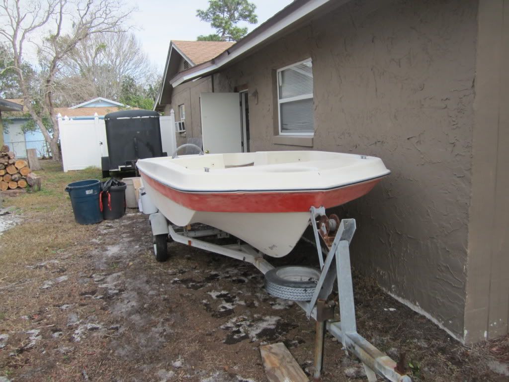

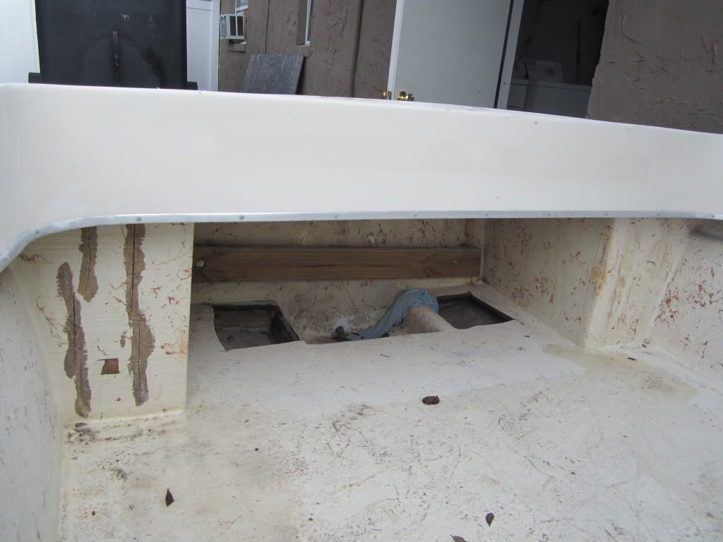

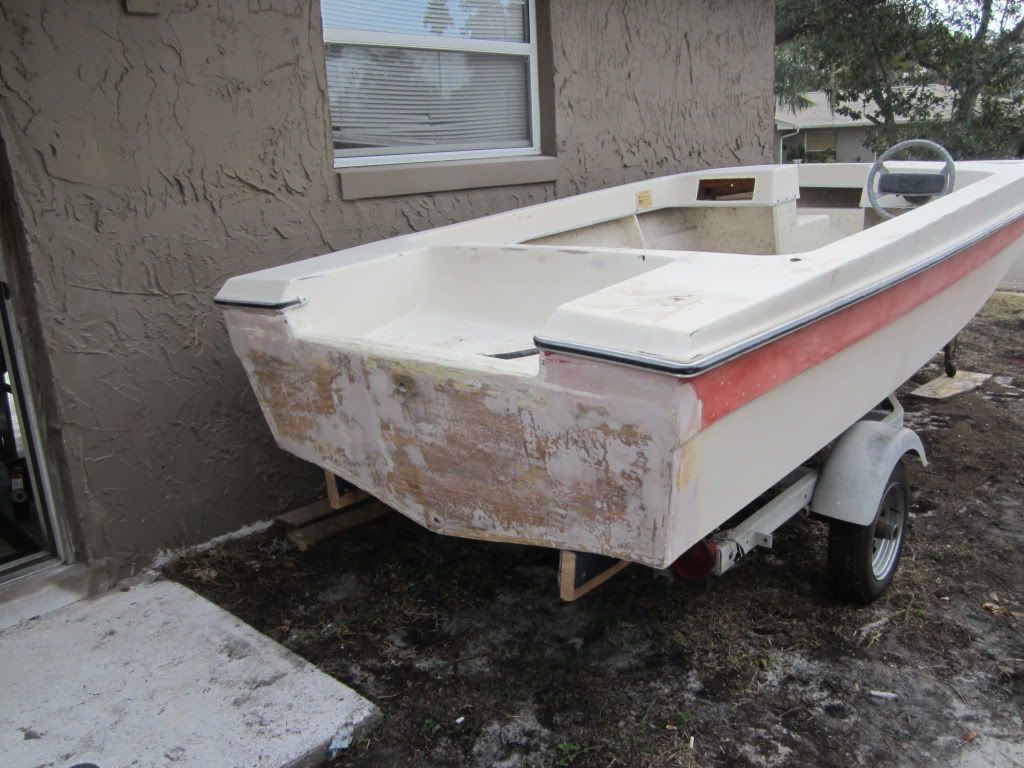

Well im just finishing up the detail work on this 15' Riviera trihull and gelcoating this weekend. all new transom wqith 2- 3/4 ply drilling into boat, glassed, sealed with 5200, and bondo smooth. So Im on the hunt for a motor locally on craigs and found a 115 evinrude mostly freshwater. The boat is rated for 70 hp. I wanted to overpower, if i can find the right motor, any suggestions for this boat. I was looking at a older 90hp but its the same motor as the 115. or should I stick with something like a 50

Stay with 70 or less, Capt. Overpowering and/or overweighting are dangerous. That Riviera 15 should perform very well with anything between 50 and 70HP.

Beyond the danger factor (especially on a boat like that one), If I understand hulls right - generally overpowering a tri-hull offers little to no advantage over the rated max. That boat, with a 70 on it will be more efficient and should be able to pull two skiers with two in the boat.
The 3cyl Evinrude/Johnson 70 is a sweet motor, and would work nicely on that boat.

Before hanging a 115 on the back, you had better know what you are doing. You will need to reinforce the transom, rebuild the stringers and floor, put in crossmembers, and solidly attach the seats to the structure.
Believe me from first hand experience: I have a 14 footer with a 125. I spend one hour running it and eight hours re-gluing it. These smaller hulls are not designed to absorb the stresses the higher speeds place on them and need to be significantly reinforced to safely handle the speed.

Back in the days of the "fat 60" OMC, a friend built a boat and put that engine on it. First time out, in salt water, he hammered down for his first hole shot and ripped the whole transom out. Engine was submerged and only hanging on by the cables and the boat was sunk up to the bow....for awhile. Got towed to shore before it totally sank.

That said---NO- you are not going to rip out the transom on the first hole shot but eventually--probably sooner than later-- you will get stress cracks in the glass and yes, the transom will weaken. So, some aluminum plate strategically placed is necessary. The 45 pound weight difference should not bother the boat but it will sit lower in the water at rest. AND, at cruising speeds, oh, say about 30-35, she probably will handle nicely.

Oh the dead weight isn't what gets you it's the twisting moment on the top of the transom caused by the torque put out by the prop and the distance the prop is from the top of the transom what really does it.....course bounding down a rough road with a rough riding trailer and the engine flopping up and down can add both problems to the transom...weight and torque.
