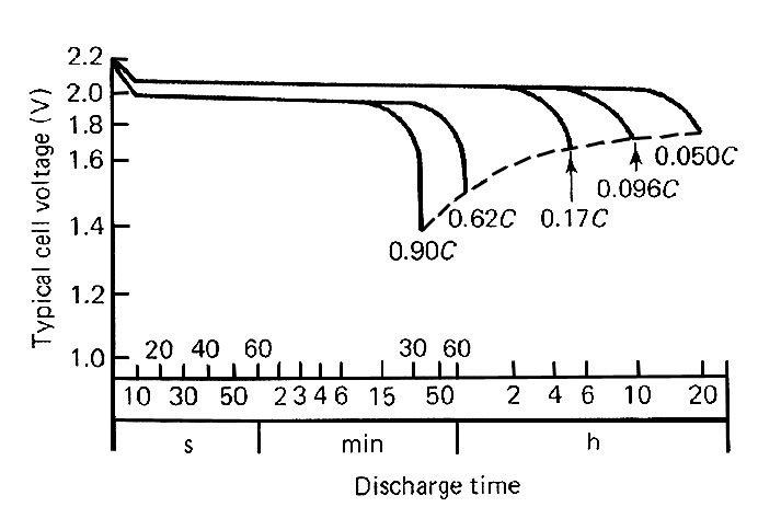

I just wanted to elaborate on the part about when to stop discharging your battery. Keep in mind using 12V should be fine, or any of the low voltage monitors they described! I'm just telling you how I'd do it to get maximum water time out of my battery without damaging it since a generic low voltage monitor isn't calibrated for my battery. Also the switch idea is great, because of the differences in batteries I'm about to explain. Silvertip's reasons for using the switch show how different batteries can be.
Most batteries have this drop-off point where they start losing voltage very fast (EVERY battery is different). When you find where this voltage point is for your batteries, then stop discharging them before this point and no damage should occur.
individually testing each battery would be best. You would then select the highest drop-off point of the two batteries and stop using the batteries before this voltage (See graph link below). To do this you can just keep measuring your voltage with a multimeter while you are using the trolling motor. You will see the voltage slowly lowering as time goes on, then at one point you will see it start going down fast.
Digital multi-meters use very little power since they put a high resistor in parallel with your circuit, so don't worry about it using too much power.
Here is a graph of different lead-acid batteries. Your battery will most likely be one of the higher C batteries.
http://www.powerstream.com/z/dh.jpg
The "C" rating means that the batteries maximum discarge is that many times the amp-hour rating. So if a battery is 1 amp-hour (Not amp/hour), with 20C, then it can continuously and safely discharge 20 Amps maximum for 1/20th of an hour. Likewise a battery of 1C which is 2 amp-hour can discharge at 2 amps for an hour (and no faster). If you can figure out your C rating, then you can see how your battery should perform among these guide lines. Notice that a 1C battery should discharge at full power in an hour (no less) but if you look at the graph, they discharge faster than that! Keep that in mind, as their maximum Amp-hour rating is higher than is acutally useable.
About my previous post, silvertip is right, series does not add the Amp-Hours, my mistake.
Eric,
You don't understand what the "C" means. C = capacity of the battery. In the graph, those discharge curves are all for the same battery. The individual curves are the discharge rate of the battery in terms of precentage of C. If your battery capacity is 100Ahr and you discharge it at 0.9C, you are discharging at 90A. Likewise 0.1C is 10A. The various curves show the discharge at various rates all for the same battery.
You still don't understand what causes the internal resistance of a battery. You may want to try reading the links you posted.

Eric,
As far as the OP is concerned, I don't think he really needs to care about internal resistance of batteries.
This link that you posted is the best. It explains what you should be discharging to:
http://www.windsun.com/Batteries/Battery_FAQ.htm#Cycles vs Life
Ah you are right, for that graph it is the capacity of a battery, the reason I explaind C as I did above is because the batteries we would work with would come with a max amperage rating as described by C, and it would be something like 20C (And for your useage of it that would not make sense). But, yes, that is how they are using that C. And thanks for the info on internal resistance. It is mostly dependant on the rate at which you are discharging/recharging the battery, however a full recharge due to the internal resistance and the heat it causes can damage a battery I have found. (Not increase the internal resistance, misworded that).

Eric is apparently working with Lithium Polymer, Lithium Ion or that style of battery where discharge "rates" are listed as xxC (20C or 30C for example). A 20C LiPo for example can be discharged at a rate that is 20 times its rated capacity. Exceed that rate or damage the pack and you have and explosion followed by fire and smoke. But then again, all of this has nothing to do with the posters question and his eyes are proabably starting to bleed.
