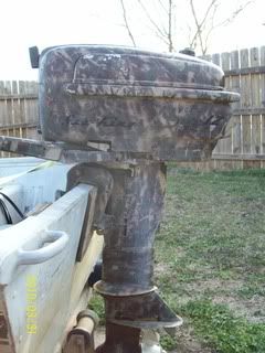

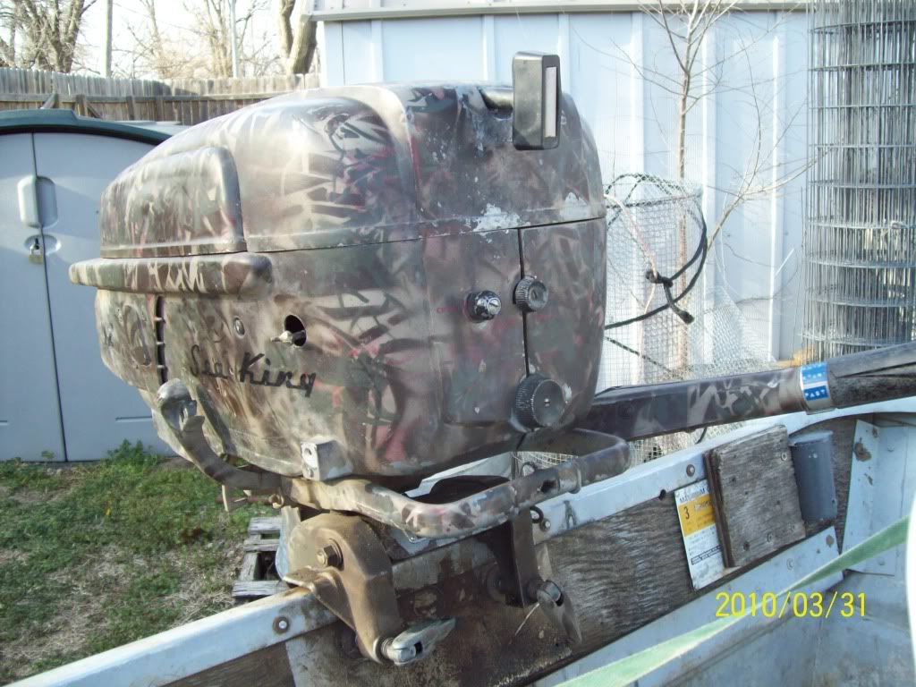

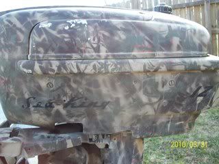

Really need a model number to verify what it is, Jason. If you can't find that post a photo.
Sounds like you are only making power with one cylinder or your Link 'n' Synch is waaay off. Once we know exactly what you have we can help you get her humming.
Mar 5, 2009
22
Re: 12hp sea king trouble!Help
Here is the #'s
Montgomery Ward
Model No. GG90165
Serial No. 65X633915
Here are photos also. I have painted it.
