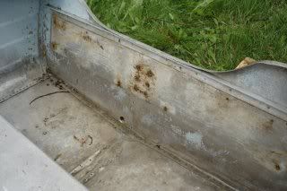

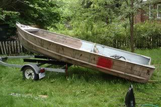

So i bought this sweet 14' aluminum boat but it was in rough shape and in need of some love, I'm in college and needed to do it all very cheap, so when you see me cutting some corners like glueing two pieces of ply together for the transom thats why!
This is how she looked when I got her.

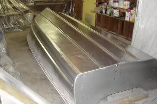

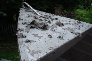

Used a chemical paint remover to strip the ugly paint.

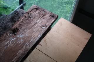

Pulled off the old transom and gusset (gusset had a crack from the transome being so rotten and the outboard flexing it so I got it welded)
rotten transom
gluing a couple pieces of ply together for new transom

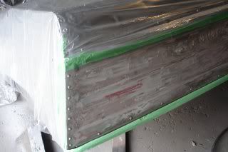

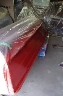

primed the bottom
aluminum coat

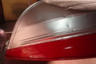

Masked off all aluminum colour
Spraying the Red

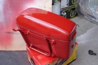

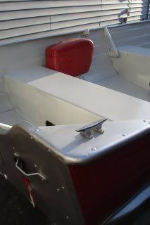

painted this little motorcycle storage container to be mounted inside the boat

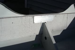

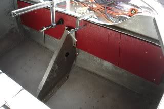

mounting and drilling up transom

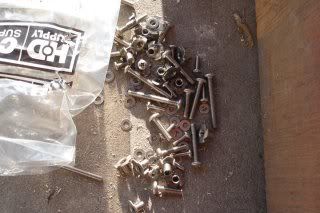

all new stainless hardware

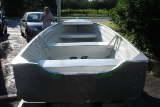

grey interior coat

paint completed

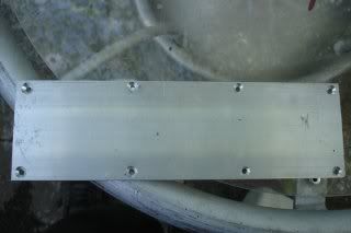

fabbed up this aluminum plate for the outboard mounting screw clamps
installed
storage box installed

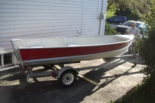

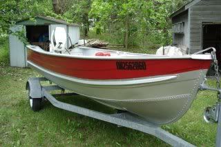

new number and outboard installed!
ready for water
Maiden Launch!
Hope you guys enjoyed my pics, was lots of fun working on it, Just got a 84 Doral 16.5 with OMC 3.0L I've started playing with.
