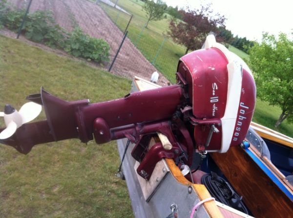

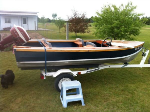

The starter housing (376665) on my 58 QD is broke where the starter pulley bolts to it. Is the metal some sort of pot metal? Probably can't be welded. This little motor runs great and looks like a survivor to boot.
