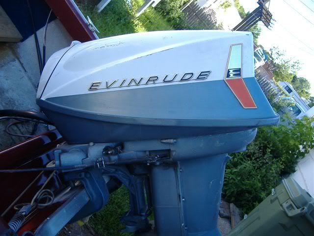

I've never done one before. I heard it's no big deal. I've worked on small engines before and large ones, but not boat engines.
Any tips?
my motor:

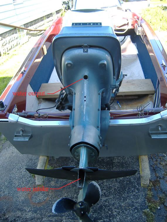

Your upper arrow is the exhaust relief outlet. Your lower arrow is pointing at the exhaust outlet. The water intake is on the upper side of that spout, with a screen.

So does this mean unlike newer motors you don't see streams of water coming from under the motor? we put the motor in a garbage can full of water and tried running it. We only let it run for about 30 seconds and saw no water jets coming out, BUT the water in the bucket was circulating alot.

Correct, they did not add "tell tales", or "pee holes" until much later than your motor was produced, unless it has been retro fitted.

On that engine, you should see a mixture of water and exhaust coming out of the exhaust relief hole I mentioned earlier, once the thermostat opens. However, if this engine is new to you, you should replace the impeller as a matter of course.
Note that the lower unit needs to be immersed in a barrel well over the anti-ventilation plate or it will not pump water. I suggest immersion to the point where the outer cover of the midsection begins.
