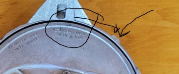

Crosbyman
Nov 5, 2006
5,805
when recoiled the small arrow should be lined up with J ZONE for Johnson models

JOHNNY1963
Jul 6, 2021
7
I am using the same rope as I was before when it was working properly.
When I wound the spring, I lined up the arrow within the JF range. Once the rope is recoiled it ends in that spot out of the range.
