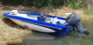

I turned my 1967 Glastron Bayflite v-163 into a fishing boat for both ocean and lake usage. Bought it in 1995 and since then remodeled it 3 times. Last remodeld I convert the boat into a Center Console to gain walk around mobility in the boat. This boat is fast and very stable and great in the lakes. I live overseas in The Republic of Panama and we have superb fishing down here. Easy to trailer everywhere. hope to get many more yeras from the boat.
