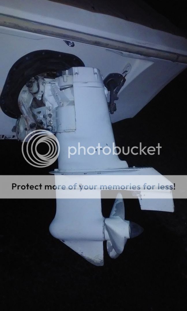

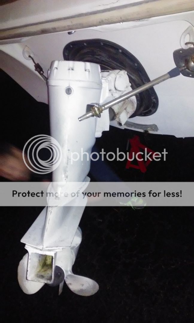

The boat is a 1969 Larson. It has the Buick 225, which seems to be a winner, and has the original OMC outdrive. Judging by the number of missing bolts on the outdrive, it appears someone has been attempting to work on it. The boat cover and interior seem to be in pretty decent shape. But being that this is my first boat, I knew nothing about what to check before buying. I didn't discover until I got it home that the deck has some soft spots back by the transom and the transom itself has some cracking in the gelcoat. I'm not afraid of having a project, I just want to make sure it's worth doing. Some of what I have read on here makes me worry that the outdrive on this boat will make the project not worth while. Since you are the experts, I would love to get your feedback on this, if you would be so kind.

There are people on here who know the Stringer drive system, I know Cobras well but not Stringers. The issue here is that this drive system as not been made in about 30 years, and some parts are hard to get. I would check around to see if any good marine mechanics would work on this set up, because if not then you are going to have a tough time to keep it going, even if you can find parts.
50,932
You have a boat with an obsolete motor and an obsolete drive. There is nothing that will change that.
If your handy with tools and searching for parts, you should be able to keep it floating for years

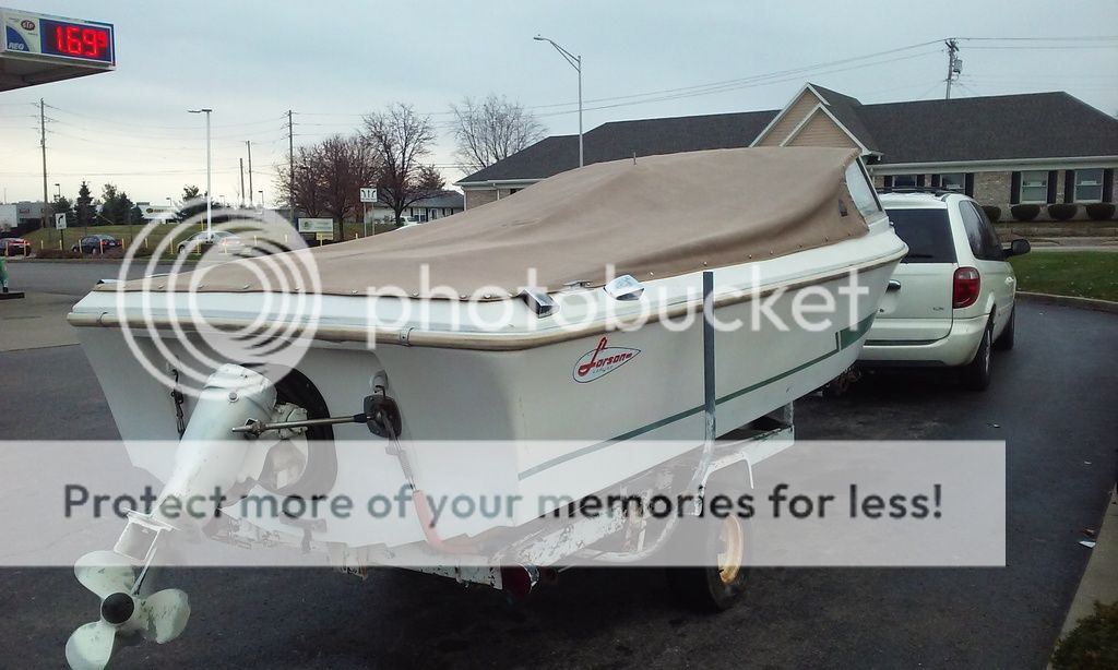

This looks like a fairly decent boat from the pic. Unfortunately the two problems are the engine and outdrive. Not because its OMC but because of their age. The Buick engine was replaced sometime in 69. Parts are probably going to be hard to find. The outdrive is an electric stringer. Of the three different models OMC made this was the most problematic. They used a series of electromagnetic coils to engage forward or reverse clutch springs. I would bet this boat already has shifting issues. Then to boot you have wood rot. I just think your going to be doing more work on it then enjoying it. Dont know what your shot gun was worth but you might be better off cleaning it up and selling it for what your gun was worth.

Does anyone know if a newer outdrive will mate up with it and fit the hole in the transom?
Bondo
Apr 17, 2002
71,259
Ayuh,..... Welcome Aboard,..... Unfortunately. No other drive will fit, without glassin' in the hole, 'n recuttin' it,....
