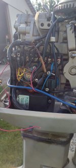

Kenny I understand you measured 13.6 at battery clean all connection s at battery terminals check voltage at starter solenoid if you could also take picture of screw board or explain where the bord is would help look for all fuses clean their connections let us know what you find

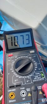

The screw board is on the right side of the motor. I am only getting 10.7 volts when I measure the power input wire of the amplifier
