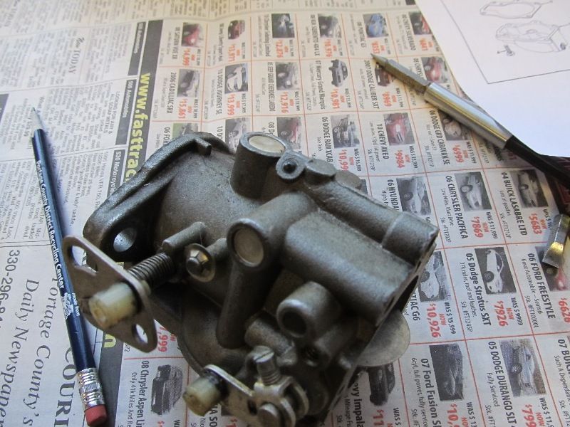

Looks like 3 core plugs. Should I remove all 3? What tools and techniques are appropriate? Two on top
One on the bottom facing the bowl

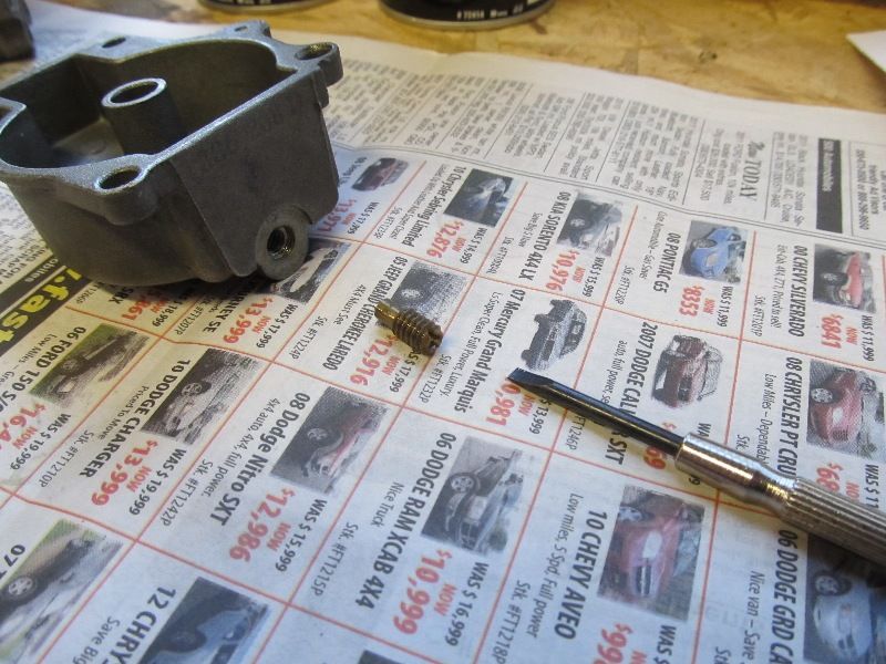

I removed the high speed jet with a narrow screw driver

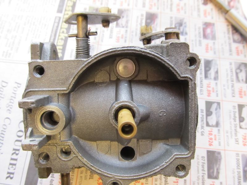

Pic showing the nozzle and orifices
These all show the top carb. Looks pretty clean to me so far as I have not started to clean it yet. Maybe I'll see more issues in the other 2. Please feel free to comment on any items regarding cleaning and re-installing. I have bookmarked a post regarding the link and sync and will be looking to make those checks later. Or, am I off-track and my running ploblems may be something else.........?????
