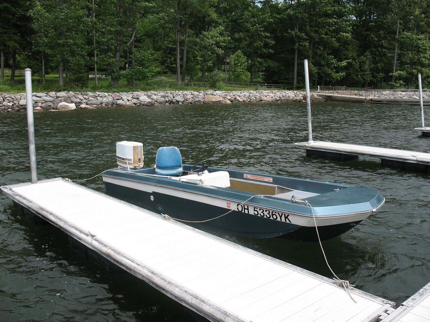

The engine in question is, as I'm told, a '74 Chrysler Magnapower 90, 3 cylinder, 2 stroke. The engine was almost always used at least annually up until a few years ago; attached to what looks like a Chrysler Bass Hunter (based on photos I Googled of Chrysler boats from that era) it ran pretty well from what I recall too. I haven't yet examined the engine personally, but I have been told it will start and run for a few seconds then die. My uncle tells me that he thinks the problem is with the magneto/coil and he is fairly certain it's an electrical issue.

PS - if anyone can shed insight into what the boat actually is, I'd appreciate it as well.
Photo at http://i60.photobucket.com/albums/h30/theterminator93/Vacation_07/IMG_0690.jpg
