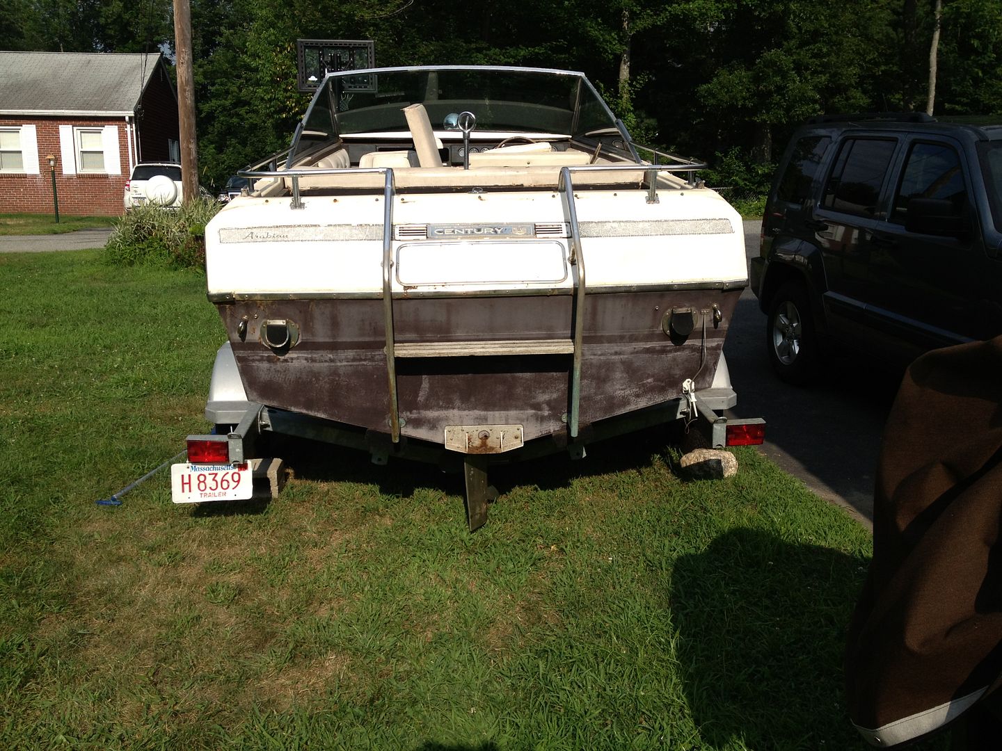

I have a 1975 johnson 6hp. I been having problems with gettin the water tube into the upper gromet. Has anyone here had experience with installing it. Any tips or how did you install it? I install the gromet into place but now I can't get the water tube to sit in place. Before that I tried putting gromet on opper tube and tried putting both of them in at the same time but it wouldn't go in. Any help would be greatly appricated.
