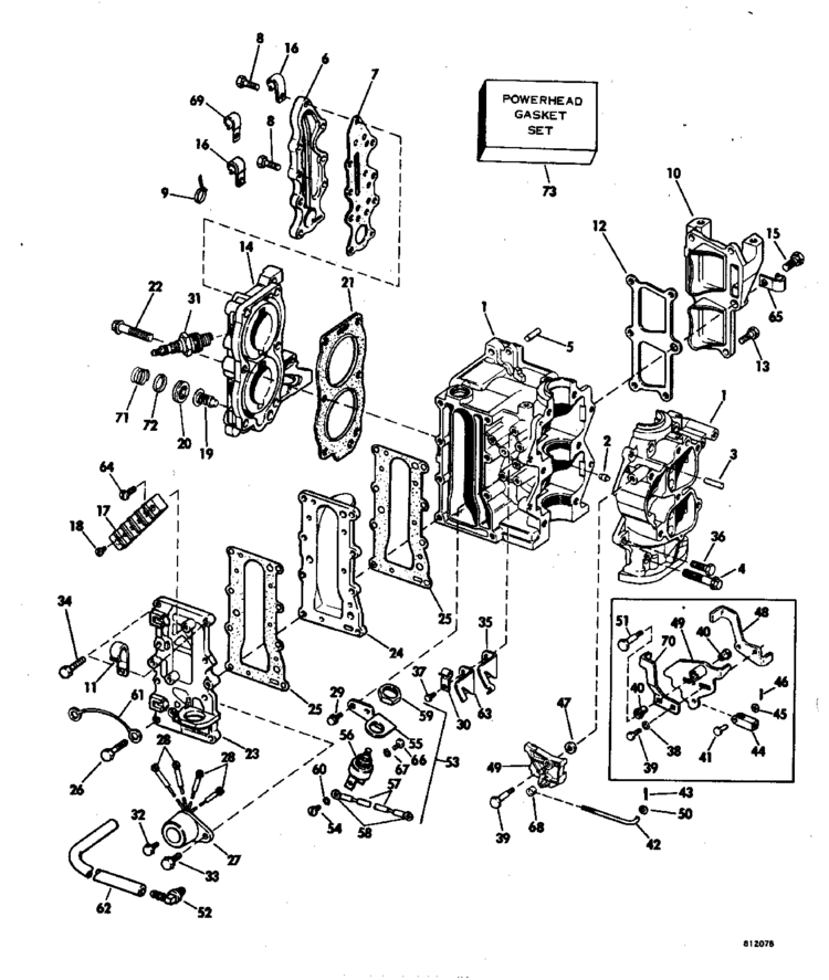

Thanks for the responses... I've been traveling so haven't had a chance to follow up or investigate further. I'll check out the specific suggestions (#35 and 42) next time I can get out to it. FYI, I'm in Winnipeg Canada, but cottage (and boat stuff) is 2 1/2 hours away, north of Kenora Ontario.
I don't think it's related to the shift linkage or brass connector. All was fine after the last impeller change. I don't think I used this motor last season at all.... I just put it on a spare boat this spring, and it came up with this new issue. It has always had a bit of a whacky aspect to the throttle/gear change interlock mech. In neutral, if you adjust the throttle as high as it will go, it barely bumps up the idle. The engine still starts fine like that even when cold, but I've thought either the interlock system, or timing advance must be a bit out of adjustment. It's been that way since I first got this motor (well used) about 15 years ago. Finally time to get into it I guess!
