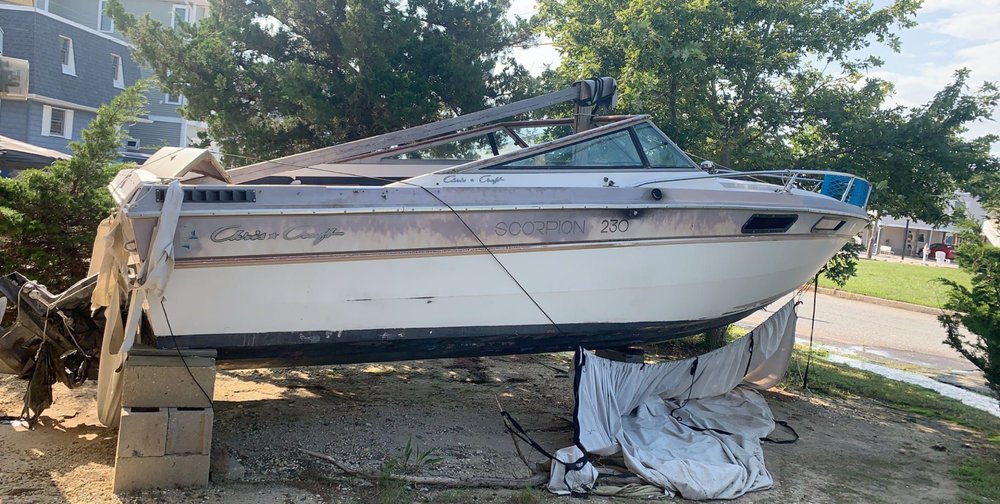

So here’s the rundown... I have what I believe to be a 23’ 1984 Chris craft scorpion 230. Now the boat hasn’t been started in about 4 years but before the sat the engines oil was changed, winterized, and flogged. Over the years I’ve had to get multiple covers for the boat due to them constantly ripping so the boat has also been subject to weather in between cover replacements. Before the boat sat the engine ran well it is a 5.0 V8 mercruiser 315cc with alpha one drive which has barely 150 hours on it at most. But although the boat ran well the interior fabric is very beat up and as far as the dashboard only the rpm, oil temperature, and battery gauge worked. I also suspect there was a problem with the battery charging while the boat was running but have not confirmed this issue. Now the boats Hull is in good shape... no leaks maybe a couple spots where the paint wore down to the fiberglass but nothing major the bottom has no cracks or leaks as well... now I know a full restoration is a huge money pit which is why I won’t but I want to get the boat back on the water at least... fix the dashboard gauges, figure out the battery problem (if there is one) and other mechanical issues that may rise I’m not too interested in cosmetics due to the increased cost. So I came here hopefully for some good advice on the approach I should take before starting the engine again and going forward with this project any suggestions or ideas on where to start is much appreciated
