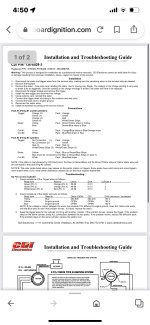

Finally got a chance to get back to work on motor. At your advice I inspected fuel system and everything appears intact including diaphragm. Only thing I have not done is a visual of inside of tank, however,I upgraded my multimeter to a nice Klein model and got vastly different results from the tired old analog one I had been using. The first pair of blue and yellow that feed the module for 1 and 2 were at 1.6k ohms. Yellow to ground was 2k and the blue to ground was 111k ohms
The second set was at 600 ohms between the pair and 2.22m ohms to ground.
Could the heat from operation exacerbate the situation of what appears to be an already compromised circuit on stator adding to the randomness of it?
