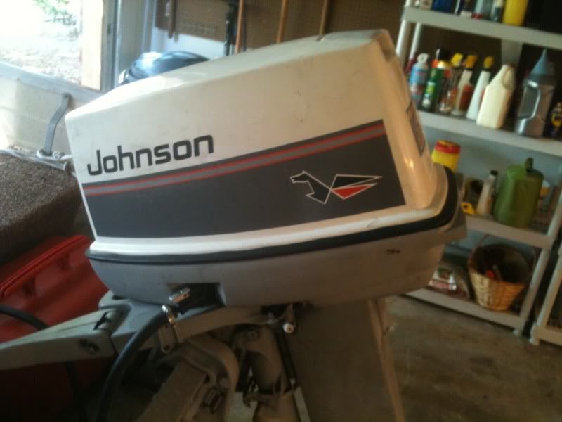

Hi guys I just picked up a small 14ft aluminum Mirro craft that has a 1985 25 horse johnson on it and the lower unit on it looks like its older than an 85 to me? But the title says 1985 and matches the serial number. Maybe I'm just crazy but i swear it looks like something from the 70's.
Here is the model and serial number along with some pics. Thanks for your help.
Mod#- J25RWCO5
Ser# E6080925
I used the INTRODUCES method to verify that it was an 85 powerhead/casting at least and I'm pretty sure it is an commercial engine.

Look for a oval cover plate with 2 screws on the side of the leg. Behind is the shift rod coupler. Completely remove the lower screw and the gearbox may be pulled down.
As a side comment, your engine seems to be mounted far to low on the transom. Normally the ventilation plate should be about 1" below bottom. Too deep and you get a lot of spray and loose speed. Buy a small drum to use when flushing, far better that any muffs!!!
TEMPO used to make a flusher that could be used on your engine, however I do not recommend it!

The boat actually came with one of thous flusher it was under a seat and i did not see it, but its all rusty and looks like a POS in my openion i will just use the barrel, i mainly use in freshwater so not a big deal. So your saying to release the shift rod linkage it is actually located on the side of the leg? instead of behind the carb like on say my 1988 90hp johnson? And Haffiman I do not think it is mounted to low because it cannot go any higher then it is not it is already sitting on top of the transom and has been that way since the 80's seemed like it ran fine to me when I took it out. On a side not i did try to run it in a barrel yesterday afternoon so it kinda scared me, then i decided to take it to the lake and bam was pumping water..did I not have enough water in the barrel? it was about 3in over captivation plate. Thanks
