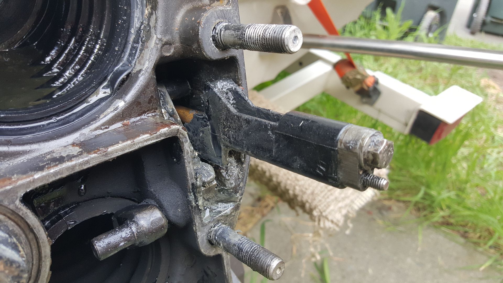

ok so i took the drive apart and this is what i found. the shift guide is broken... shift cable is still good...
and is it normal to have water in the top bellow?

Upper bellows must be absolutely dry. It's not hard to replace them. Make sure to pump grease in the fitting on the u-joint.

Try disconnect shift cable on both sides and see if it moves freely. If not replace, it should move without any resistance. You'll need the tool to adjust it, but can be done without... All the tool does is holding belcrank in a certain position while you adjust the length on the engine side.

Don't judge it by the shift leaver, it gives you a better leverage and you won't feel if cable is sticking... Just undo cable on both sides and try it that way. You will need to readjust it anyways.
