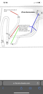

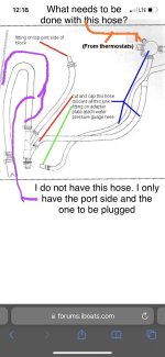

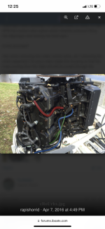

Hi guys I’ve been following the threads on water control valve delete and I think I just about figured it out. I just don’t know where the hose that comes from the thermostat to the water control valve ends up after the delete. I have all part numbers from previous threads and pics of what to cap and what to discard all together. I am just a little confused as of that one hose from the original thermostat to control valve.

Thats a cowling siphon hose and that hose plus the crossover hose goes away when you replace t-stat covers
