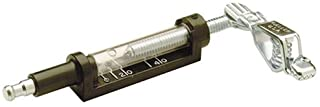

39,418
The 90 HP would be a 3 cylinder I think.-----Spray some mixed fuel into the carburetors while cranking it over.----That should offer you a clue as to what is going on.------If it does not bark at you , it is not a carburetion issue.-----My bet is -----NO SPARK----at the plugs.
