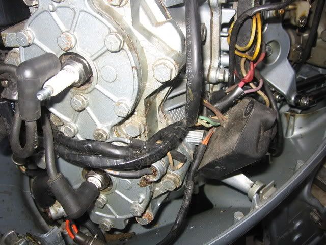

Also, just to make sure, I should be removing the bigger-size bolts (sitting around the outter perimeter)that secure the head to the block, not the smaller ones forming the inner circle, correct? pls refer to attached picture.
thanks.

Pull the heads if you must.I would wait until the engine gives you a reason to.
Kind of almost fits under the heading "Fix it till it's broke"
