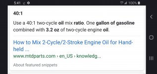

3.2 ounces of oil per gallon, is 40 to 1 ratio. It really won't hurt your 50 to 1 items to run on 40 to 1 premix. I premix all my 2 stroke gas to 40 to 1, then run it despite whatever something asks for. You may have to change a spark plug slightly sooner, but not harmful, just a little extra lubrication for bearings, pistons, rings, cylinder walls, etc.
