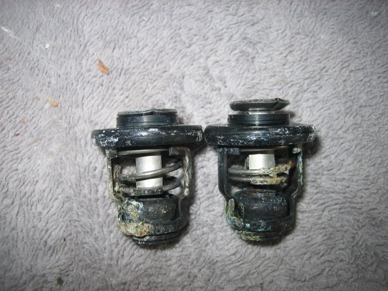

Pulled the thermostats out today. Both had some crud built up, but more importantly, I found the equivalent of a smoking gun in the starboard head. Check out the t-stat on the right.
That's the good news. The bad news is boats.net shipped me some POS aftermarket thermostats that won't work. So much for the test run tomorrow.
