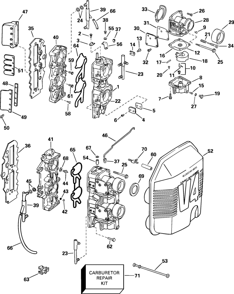

I have posted about this a few times and I?m almost at my wits end with this motor. Below you can see everything I?ve done with the motor, the carb work and gaskets being most recent. Dropped the boat in the water this past weekend and had no success, the motor still stalls out and will not run at high RPMs at all while under load. I took the upper cowling off to find gas in my engine compartment, took the air silencer off (#52) and revved the boat up in neutral to see what was going on. All four carbs are spitting out fuel when revved up to the point where it filled the bottom of the silencer with fuel. The top left carb seemed to be the worst and was firing smoke out of the mouth of the carb when revved up. This leads me to believe the motor is getting way too much fuel. Ran the motor with an external tank as well as off the internal set up, no difference.

Gee, I assume you have the correct OMS pump? If so, it would be surprising to see it overpower the carb inlet needles, allowing the carbs to flood. Are the carb floats set to specification? I would recheck those, as you cannot fix anything else with the carbs flooding.

Not much on your list would solve the problem of blowing fuel out of the carbs. The VRO (OMS) pump wouldn't have anything to do with it.
Reed valves
Needles and floats
Bad blow by on the rings
Carb not assembled correctly.
Primer either failing or the lever is in the manual position.
