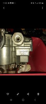

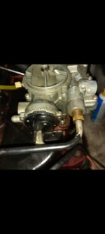

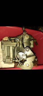

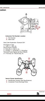

Ronrymanr
Jun 14, 2022
15
I took pictures before I disassembled the carborator. Suggestions about a possible used carborator replacement for this motor. Or Suggestions dialing in the mixture. The poping occurs as the engine warms . My instinct is to walk back and push down on the throttle to idle down. The way that po. Attached the controls cable is off a bit. Pictures show the carnage. I appreciate your help

For clarification
VP GL motor that a Merc carb was installed? Don't see an issue with it so long as it fits
Did it run fine last season?
No need to tune in water until it's running fine on a hose
The popping as it warms up motor might need timing checked, cross tracking inside the distributor cap or valve is sticking and not fully closed
If the carb doesn't fully go against the idle stop then check for something binding on the carb. The throttle cable is used to hold the carb at idle because there is no return spring like on a car

Thank you so you don't think it will stop if I bring out the the mixture screw to a richer setting?
alldodge
Mar 8, 2009
43,519
It shouldn't, might sound different but a healthy motor will not die if mix gets a bit richer
