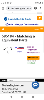

I didn't have your model number but it's your year and your hp. Need to check model for sure. I was told BRP was still making and supplying parts. Anyhow, marine engine.com
saltchuckmatt
Jul 19, 2019
2,863
Sorry , but he needs the one from port side !---The 2 switches are different.
Race, the parts breakdown that I looked at doesn't differentiate from port and starboard. Just says temp sensor. Where do you see that or are you just pulling our legs?
saltchuckmatt
Jul 19, 2019
2,863
On the parts fiche for a johnson 150 #s 15 and 20 are the sensors
Wow, I went to parts first where is just list the sensors and doesn't differentiate from either side. But when you go to parts breakdown and then individual parts you get the description. That sucks! I wonder how many people have gotten screwed on that one. Also, one would think a temp sensor would be the same on either side.
