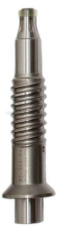

Continuing this project, I have replaced all of the broken gears
and tagging along but I just cant figure out how to separate the lower shaft and upper shaft
the original broken upper shaft is 21 inches now i have a 25 inch which i need to separate from the lower shaft
so i can use the lower new shaft from the 25 in my 21
Anyone knows? see pic View attachment 351128
