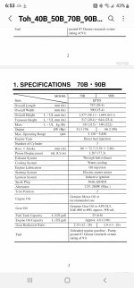

Seem to be having a similar is as the previous person I changed the plugs , and all of the sudden it started surging from 1500 rpm to 3000 then it and the lower end locks up when I put it in gear and stalls 2006 model md90b 3t9 s#037638xe I've purged all the air from the system. By doing pumping the bulb and then releasing the top float bolt till the air is out . Have not checked pressures , not really sure how to do that. HELP !!!!

So it ran fine until you changed plugs? What the heck is a top float bolt? Gauges go on the schraeder valves on the fuel and air rails.
