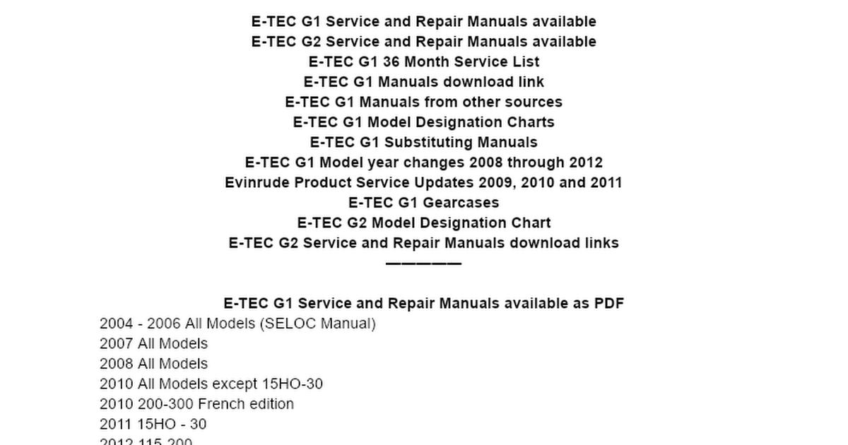

could be lots of things and if you plan servicing that ETEC get the EV diagnostic software to help out.
A sane EMM can only mess you life if it detects a sensor fault or various specs out of range incl shorts and opens on inj and plugs , voltage levels, position sensors on the throtle position or crrnk position sensors etc...
download you manual for you engine size ???
